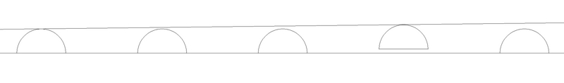

Here is why I say leveling with a long planed surface, (be it radiused or flat) will not work efficiently. it can be done with the sharpie technique as mentioned above but you end up lower frets that did not need to be lowered to get to a level plane, and thereby causing much more dressing work. Using a fret rocker to find and fix high frets is the best in my books.

Michael, Your diagram does not explain to me why a long plane does not work efficiently when leveling frets. My experience also differs from yours. I have been using an 18" long carpenters level for 30 years to level frets. It has worked for me.

Ok lets put it this way. When you a flat plane on the fret to sand with it, is it touching more frets than the highest fret. The answer is yes. When a plane lays across the frets it must lie tangent to at least 2 frets. If you have more than one fret high it will lie across the two highest. If you have only one high it will lie across the high one and the nearest tangent possibility. In this case you end up taking of material from frets that did not need material removed from them. Keep in mind I use to do the same thing you are doing and you will reach a equilibrium that all frets are level. However they will be lower than they needed to be unless you have a way to hold the level so that it only touches the high fret or frets. I doubt any-ones dexterity is good enough to hold a 18" level tangent to only the one fret. now keep in mind here; I am not talking about taking a bunch off the already level frets. The high one will get most of the abrasion. However you will be sanding on at least one other fret that does not need it. Your method, my old method were the same and in the end we had level frets. But none the less we sanded down frets that did not need sanding.

I think there can be a good common ground here. I use a long plane along with the rocker technique. The reason I went back to the rocker is that I once had a springy fret. When I would draw a sharpie line on all of the frets, sand with the long bar, they would all remove the sharpie line equally. One would assume they were flat. Then the rocker would show a high fret. What was happening is the springy fret was pushing down when the long bar passed over it and then springing up after it passed.
